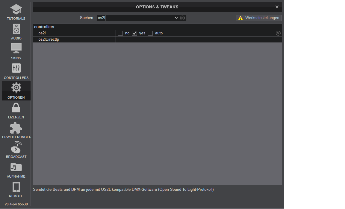

Does you have in VDJ the os2L in Options activate (yes or auto?)?
Does the Bounjour Network Service run,an the VDJ Logo in SoundSwitch ist Grey filled and the Blue dot lighting ?

Connect VDJ 2018 with Soundswitch ,think with VDJ 2020 is the self:
https://www.youtube.com/watch?v=U_ICHr4EcXs
