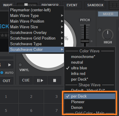

How do I get the colors of the moving waveform from Project control and import them into Controller 2020 the white red green for the stems?
    Posted Tue 06 Jun 23 @ 7:12 pm
          ok well what lines are the simple Audio skin wave form colors I can take it from there.
    Posted Sun 11 Jun 23 @ 5:23 am
 The red arrows show the waveform of which I want to change the colorsPosted Fri 16 Jun 23 @ 2:51 pm
 The red arrows show the waveform of which I want to change the colorsThe Colors of the shape Wave can changed in the Skin.XML
You can change this 3 Presets:
var_equal '@$wavecolor20' 1 --> Pio colors
var_equal '@$wavecolor20' 2 --> Denon colors
var_equal '@$wavecolor20' 3 --> my VDJ Colors
you can change the Color at:
Line 263 (not daylight blue/red)
Line 591 (not daylight blue/yellow)
Line 919 (not daylight blue only)
Line 1226 (not daylight yellow only)
Line 1533 (not daylight greyblue only)
Line 3616 (daylight blue/red)
Line 3919 (daylight blue/yellow)
Line 4222 (daylight blue only)
Line 4525 (daylight yellow only)
Line 4832 (daylight greylue only)
<group condition="var_equal '@$wavecolor20' 1">
<define color="wavevocal" value="#0059E9" deck="1"/>
<define color="wavenovocal" value="#002C74" deck="1"/>
<define color="waveinstru" value="#FFA700" deck="1"/>
<define color="wavenoinstru" value="#7F3500" deck="1"/>
<define color="wavebeat" value="#FFFFFF" deck="1"/>
<define color="wavenobeat" value="#666666" deck="1"/>
change the value="#........" to your favorite Colors.

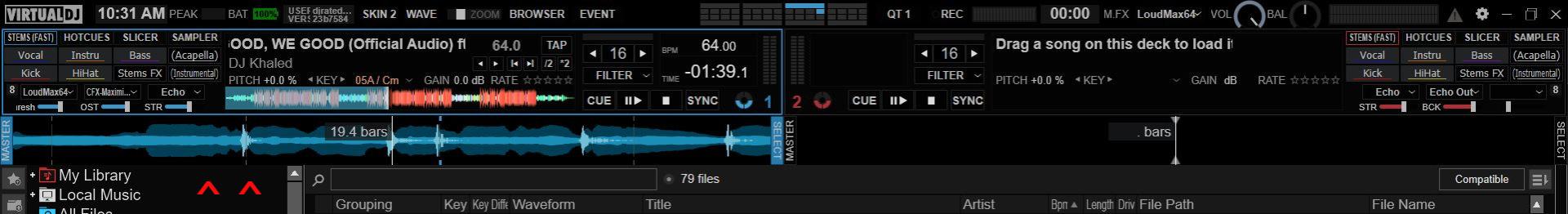

          Hello mate,
your skin is the best. I was wondering is possible to embed the hotcues like I have tried to accomplish here into the info pane (I am just hovering a floating window over it at the moment).
Ive tried really hard to find out how to embed an image in this post but Ill be honest im at wits end with doing all the work for virtual DJ, just let me use copy+paste, shortcode, an embed, an actual UI...something. I had to go forum hunting and still cant figure it out.
here are links to what im trying to do
https://i.imgur.com/XMSOmkN.png
https://i.imgur.com/Ao6vD53.png
Ive tried using BB codes, they dont work.
Posted Sun 02 Jul 23 @ 7:05 am
Posted Sun 02 Jul 23 @ 7:19 am
          Hi,
That is difficult to implement, because the Browser has any different highs. (For each Variations and Wavesizes)
I think your Idea with the floating Window over the "Info" Panel is the easiest way.
Posted Sun 02 Jul 23 @ 7:52 am

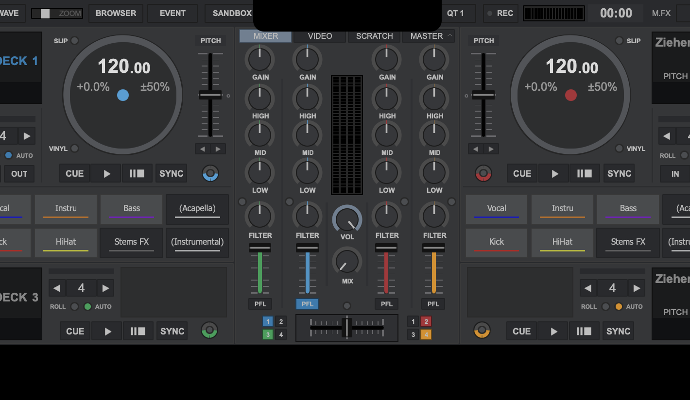

          Hello.
Macbook pro 14" 2023.
The notch covers the beatbar.
Can I move the beatbar?
       Posted Fri 25 Aug 23 @ 3:20 am
