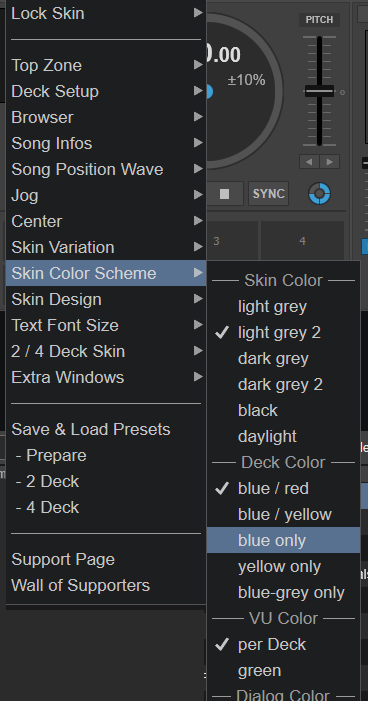

hi all
Has anybody found a way to change the deck colors
deck 1 blue / deck 2 red / deck 3 green / deck 4 orange
in Controller 2020 by DennYo XML
as i need them all to be blue or all red
i tried to change it but couldn't find deckcolor in the XML file
Any help will be appreciated.
Posted Fri 13 Feb 26 @ 8:46 am

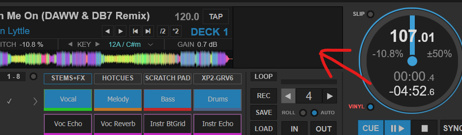

hi team
i need to know what is this area for and how to get rid of it and make the wave at full
thx all
thx all
Posted 2 days ago @ 6:36 am
This is the deck video screen. Change the mixer section to mixer, scratch or master to hides this little screens.
Posted yesterday @ 9:10 am
thx a lot dennyo

deejay_willy wrote :
hi all
Has anybody found a way to change the deck colors ...
...Any help will be appreciated.
You can set all Decks blue, yellow and blue-gray at the skin button.
Red is not include. You can edit the xml.
The colordefine are at the start of xml.
Search one of this:
<!-- -------------------color-define-not-daylight-blue-red------------------ -->
<!-- -----------------color-define-not-daylight-blue-yellow----------------- -->
<!-- ----------------color-define-not-daylight-greyblue-only---------------- -->
best way, search this:
At the next 327 rows you change the color of Deck 1,2,4 to the color of Deck 4
for example:
original
<define color="textcoloron" value="#3E9FD7" deck="1"/>
<define color="textcoloron" value="#EA414C" deck="4"/>
<define color="textcoloron" value="#27C16A" deck="3"/>
<define color="textcoloron" value="#FFBD52" deck="2"/>
edit
<define color="textcoloron" value="#EA414C" deck="1"/>
<define color="textcoloron" value="#EA414C" deck="3"/>
<define color="textcoloron" value="#EA414C" deck="2"/>
for daylight do the same at:
<!-- ---------------------color-define-day-blue-yellow---------------------- -->
Posted 24 hours ago
love u mate thx a lot
