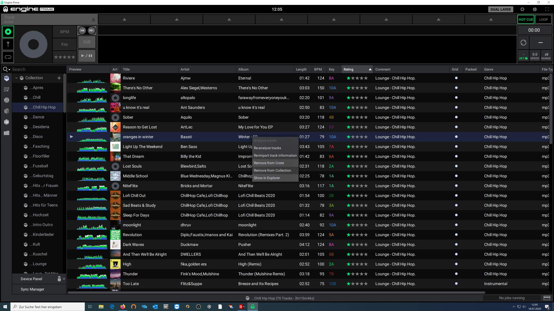

I cannot click (or right click) in engine prime to the songs and edit the MP3 tags. You can write something into the row directly. But, if the column will not be shown on the browser, then you cannot. You have to enable all columns, edit them and disable them again. And you cannot change the text at multiple rows. If you want rename all MP3 Tags from Chill to Lounge, you have to edit every single row. 10000 of them. You need help from another MP3 editor software. But, if you change some ID3 tags here and there in single subfolders. You cannot see the changes at the Prime Engine. You need to remember every single song that you have changed and need to reload the tags of them in the Prime Engine. Or you need to reload all of them and this takes a very long time. Also the rating will not be read from the ID3 tags. So i need to rate 70000 songs again. I know its not neccessary, I can also work without ratings. I have 70000 songs in my head.

yes, page 34, as i said. You can just do some single edits, if the column is visible. Anyway, with this type of managing the songs, Denon will never win against Pioneer.
No - you can edit multiple tracks at once. I've done it, I know it works.
Posted Sat 18 Jul 20 @ 10:46 am
Ive tried it. Impossible. The users manual says the same. If yes, show me this undocumented trick.
You can just change the rating for multiple tracks. Nothing else. And they are not read out from ID3.
This is just the single dot on "i". Show me how to transfer a big database from Virtual DJ to Prime Engine. And after several days of migration work (and still without cue points), show me how to update the databse, if you have made some single changes in Virtual DJ.

It's not undocumented. Here, watch this video...
https://www.youtube.com/watch?v=wWRAColLxSo

Wow, batch editing. This will help a lot. But, without documentation this is worth: nothing. Just some people will find this video.
