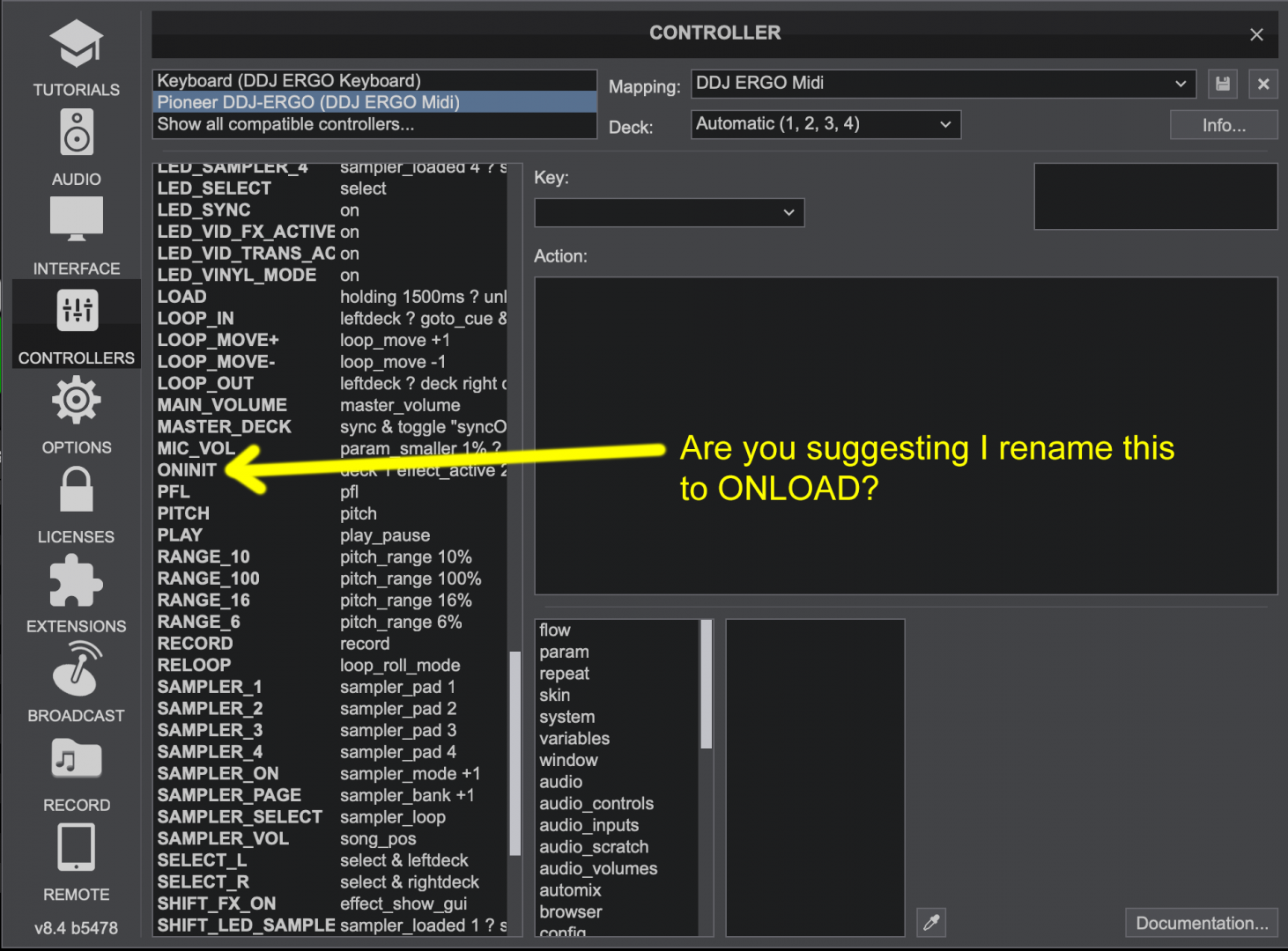

I'm having the same issue. When I first launch virtual DJ my ONINIT actions are not getting executed with the exception of a track that I have auto-load to Deck 4. That always executes but the rest of the commands do not. If I open settings and put the cursor at the end of the ONINIT command string and hit "Enter" on my keyboard all of the actions execute. Why are these commands not executing when I launch virtual DJ? Here is my ONINIT attached to my keyboard mapper
deck 1 effect_active 2 on & deck 2 effect_active 2 on & deck 3 effect_active 2 on & deck 4 effect_active 2 on & deck 4 effect_active 4 on & headphone_mix 100% & sampler_volume_master 50% & deck 4 load "/Music Crate/DJ FX/Scratch FX - Scratch Kit 2.mp3"

So you're saying in the controller options I would rename this command to ONLOAD instead of ONINIT? I got confused with your suggestion because I only have one ONINIT command and under that command I list a bunch of actions. Please see my image and let me know if that's what you mean:-)

ONINIT is executed during program start, while ONLOAD is executed on every song load, so they are not the same at all, and it will depend on your use if ONLOAD is also suited.
The reason some actions might not work during ONINIT for some actions is because they might be executed a bit too soon, before virtualdj has fully initialized, thus later overriding some of the actions.
You should be able to find ONLOAD in the Key dropdown btw.
