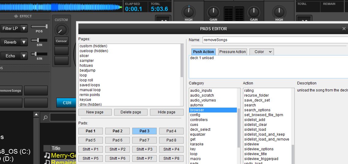

I googled for the answer and found out I need to use deck 1 unload. But this does not work. When i click on the pad nothing happens. I use VDj v8.3. Does anyone know what am I doing wrong here ?

I solved the problem partially. The syntax was wrong! It is not "deck 1 unload" but "unload deck 1". I say partially, because this allows me to remove a song only from the deck on which the script is called. So for example "unload deck 1 & unload deck 2" unloads first deck when called from the first and unloads the second deck when called from the second deck (but the first remains). My idea is to write a script that will clear all decks.

My current results are:
unload - no effect
deck 1 unload - no effect
unload deck 1 - removes song from the first deck (when called from the first deck)
unload deck default - removes song from the current deck
deck 1 unload & deck 2 unload - removes songs from both decks
This seems to be ridiculous that "deck 1 unload" does not work for me but "deck 1 unload & deck 2 unload" does. When I'll find a bit more time I will try to make screen recording so you guys could see the issue. Thanks for the responses.
It sometimes happens if a space or newline or something is added at the end.
Then the last "word" of the statement sometimes isn't parsed correctly
