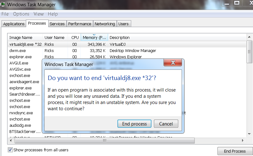

It doesn't freeze the gui, but I cannot close vdj completely nor do anything else, it appears in TM stuck at 400k memory use.
I cannot end task in TM either and when it appears closed with an X if I click on the icon it says its already running.
This keeps windows from shutting down properly till I disconnect the drive which corrupts the database.

Since End Task in Task Manager doesn't work, that does indicate the lockup is at driver level though, possibly when trying to read a file the file system failing or being very slow to respond for some reason. (Possibly bad disk?)

Here it is in TM with excessive memory use and will not shut down requiring I force power down.

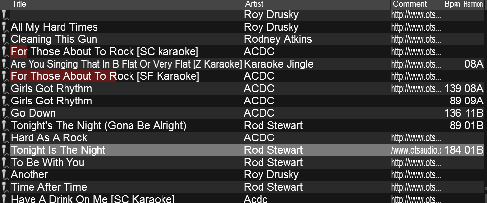

I specifically selected 20 acdc tracks just now, and instantly it locked at 0%.
So rather than power down, I unplugged the drive which stopped the hang.
At least if I corrupt the database it can be fixed quickly without messing with Windows.
Then I scanned each one of the unscanned acdc tracks individually and not an issue.
So not convinced its a file specific problem.

It may be the file.
I just loaded one that hung after a restart and it loaded.
The wave loaded about 85% and it played audio till that point and the graphics continued.
So it looks like the mp3 is incomplete or corrupt.

A way to cancel scanning might also be desired, maybe a right click option.
I'm discovering quite a few corrupt files among the 86k in this drive.
Writing them down for deletion as I narrow them down.
