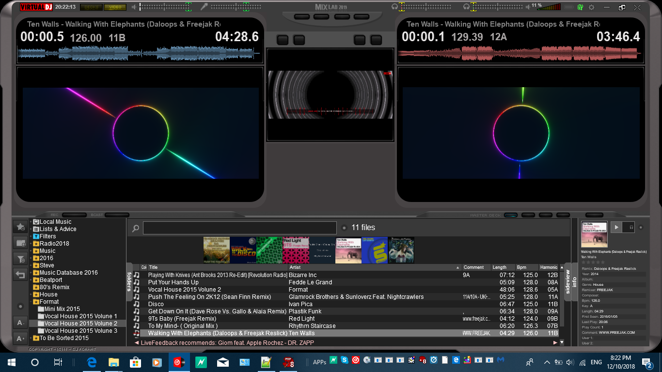

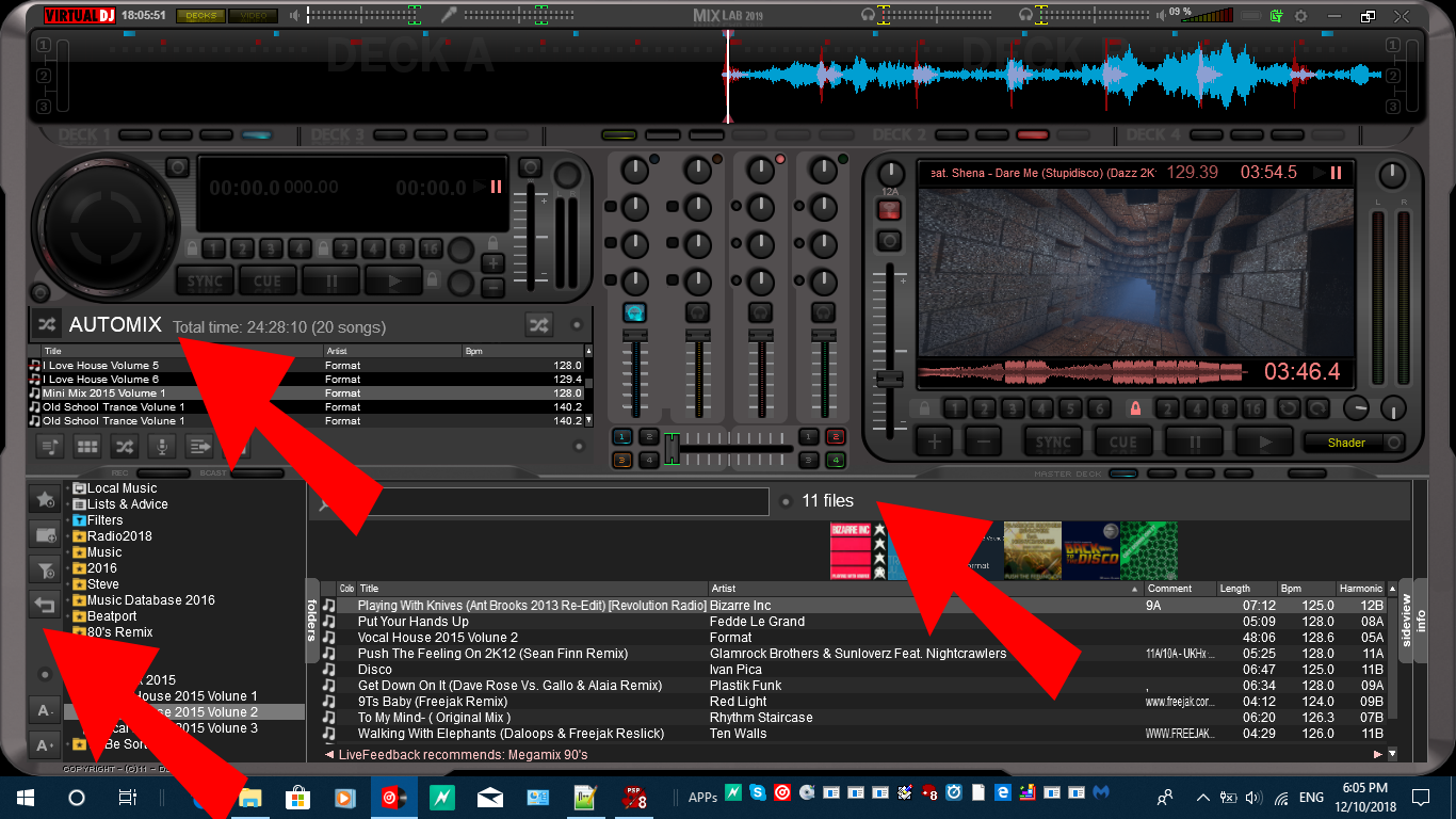

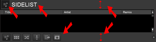

Hi guys hope you both are well . Is there any way that these areas can be made smaller by adding coat to the browser as these are Way too big .
Posted Mon 10 Dec 18 @ 6:20 pm
Loving those large video panels. Nice one Matt!
Posted Mon 10 Dec 18 @ 6:30 pm
No, their height is calculated automatically by VirtualDJ.
However you can hide them all together (and draw your own elements) or alter the height a little bit by changing fontsize
There is another complete layout which have bigger panels again for video . I’m not a video DJ however I mainly focused on audio that my reasons for Mixlab doing so well over the years it’s due to the big video screens .
So there is a layout for people that enjoy videos that have external controls.
Posted Mon 10 Dec 18 @ 8:23 pm
I prefer to have controls on the screen for when I work remotely from the ipad, however for those who permanently use a controller that would be perfect.
Main thing for me is having big enough video windows without making the browser area too small.
Posted Mon 10 Dec 18 @ 8:33 pm
Example(s):
<filelist source="automix" toolbar="no"> ... </filelist>
<browser toolbar="no" sideview="yes" folders="yes" infos="yes" effects="yes" searchbar="no" showzoom="no" lineheight="1.0"> ... </browser>
Example(s):
Tried some of that code and couldn’t get any of it to work not with the areas I am trying to do it with . Tried in the browser it’s quite a good bit of code as you can turn things on and off . But I am working with only part of the script from the browser which I found in the sticky on here The only deals with the side views . This is what the code looks like currently.
<sideview>
<pos x="+0" y="+145"/>
<size width="531" height="150"/>
<font size="18" name="Arial"/>
<fontheader size="18"/>
<colors background="transparent" stripes="#000080" text="#FFFFFF" label="#A0A0A0" artist="#D5D5D5" title="#FFFFFF"/>
</sideview>
