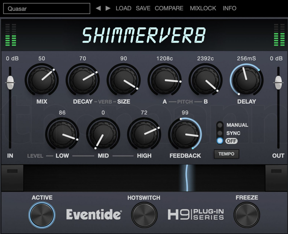

Can you not just find a vst fx that has an input and output fader on the gui and use that to do exactly what you want?
This has one

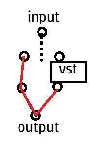

I actually made a vst wrapper, somebody paid a few beers for my time.
the block diagram for the signal path, the switch can either be full feed to the vst, or bypass the vst and let the tail play out.
