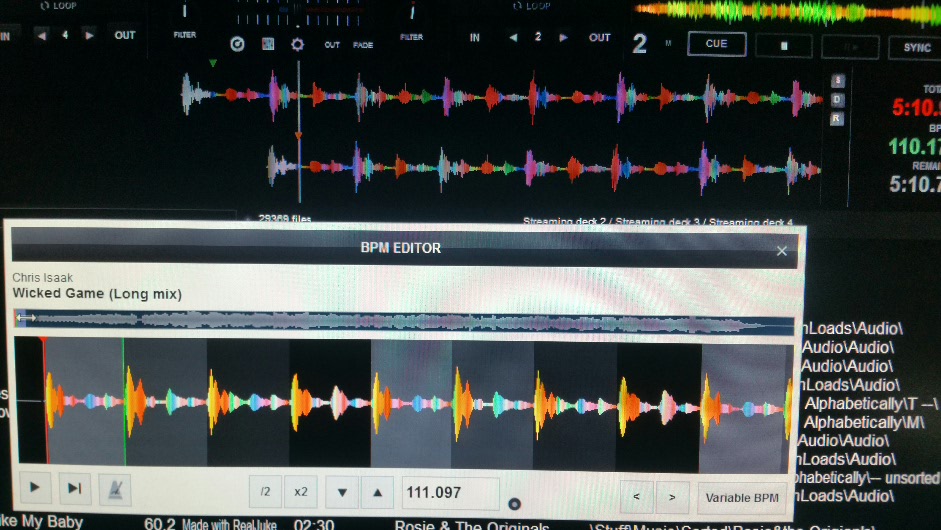

While you are thinking about the sticker drift issue, maybe you can explain what is going on in this screenshot:
Occasionally, with no warning or reason that I have so far discerned... right in the midst of a live remix, vdj will arbitrarily and temporarily, move a cue point to a position totally out of synchronization with the actual beats of the track.
This is guaranteed to produce an instant trainwreck.
Note that the track is grayed out ahead of the new bogus cue... which leads me to assume that this is by design. How do we neutralize this behavior and prevent this issue?

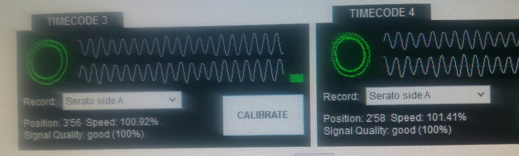

Can you take some screenshots of the timecode signal in options while timecode is playing?

During normal playback the signal looks ok at least.
Other timecode settings are default?
How does the signal look while cueing the first beat?
Posted Sat 01 Dec 18 @ 10:50 am

The signal always looks good... but it's not clear what you are asking.

When your scratching back n forth what does the signal look like??
And there are other timecode settings, what do those look like??

lower the timecode silence to Zero or 0.01, I have mine at 0.09, and try lowering your latency. clean needles,check ground cables, RCA, headshell/tonearm...
I have no sticker drift, and I'm also using the serato TC vinyl,

Thanks buddy... you are both a gentleman and a scholar.
I believe that is the only perimeter I'd not already played around with, and I had to take it all the way down to zero before it stopped losing counts. However... that did resolve the drifting problem.
