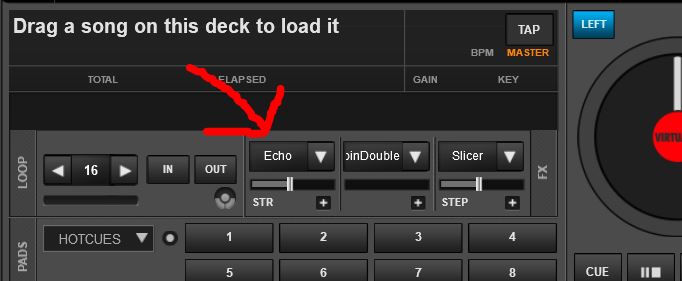

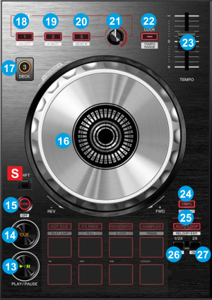

I've purchased the Pioneer DDJ-SB3 controller as an avid long-term user of Virtual DJ I want to know how I can map the effects buttons 1,2, and 3.
I would like to be able to control the individual latency of the effect I am selecting as opposed to being only able to control all at once.
And ideas on how I can do this?

You cound set up a parameter that holds which of the effects you are currently controlling
Then map a button to change that value of this parameter to switch between values 1, 2 and 3
And then remap the knob to look at the parameter and then only control the selected effects slider
But I'm not sure it will be pritical in use. I guess the SB3 wasn't meant to be used that way
You may be better of adding a cheap add-on controller with lots of knobs and set it up to handle effects
Like a Novation Launch Control
