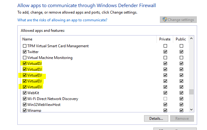

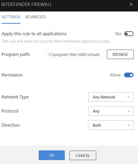

I have Windows Defender Firewall turned off completely and use BitDefender Firewall. I have the following set for Virtual DJ on both laptops:
Thanks for the suggestions; but still looking.
