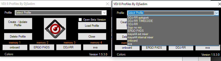

an xrisimopeieis poloys controlers exw fiaksei ayto to tool gia diafora profiles
http://www.virtualdj.com/plugins/index.html?addonid=80186
kai nai etsi doylebei to pragma afoy den briskei ton sygkekrimeno controler

to sigkekrimeno tool den einai mono gia diafaretikoys controlers alla genika gia diaforetika setarismata toy vdj (apo skins, condrolers,diaforetika options kai opiadipote diaforetikh ri8mish exeis kanei) etsi ka8e fora den xriazete na setareis to vdj apo thn arxh egw to exw boleytei afantasta

ok θα το κατεβάσω κ αν εχω καποια απορία θα σου πω! Ευχαριστώ!!
