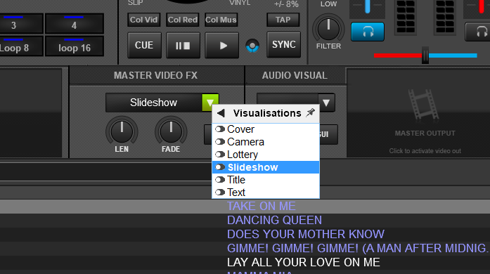

It's located in master video FX. Enable the video panel in your skin.

I think you may be looking in the wrong place
I think you may need to look on the video pane for video effects for things like slideshow

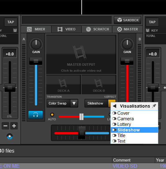

Thank you both for the quick replies.
I am using default skin.
In the middle pane I see video and under the master output window and then deck a b (side by side) I see transition and video effect.
Is this where you mean or do I need to add something to settings?
I am not sure how to enable panels.
Thanks in advance
Thanks in advance

Thank you. All sorted :-)
