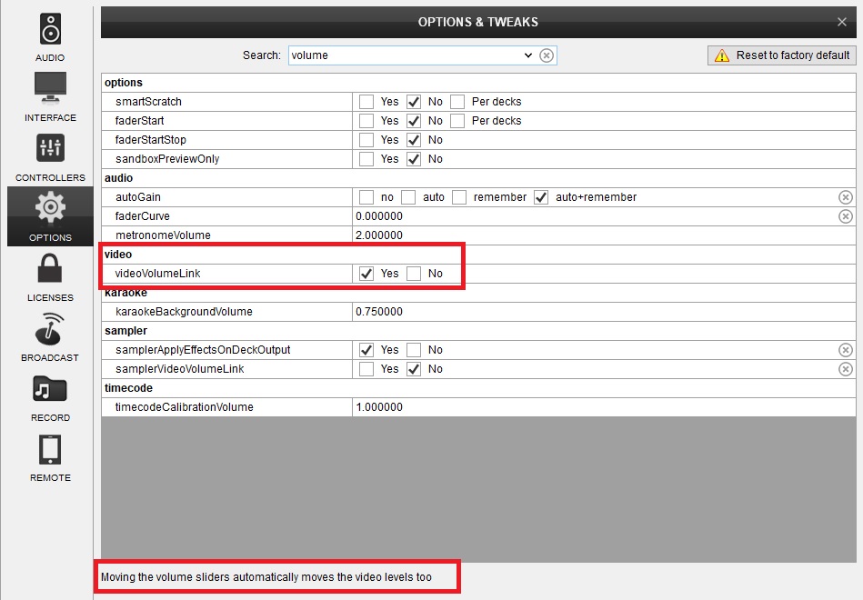

This works when you dont use the crossfader or having it in the center.
you can see that you just search for volume.
