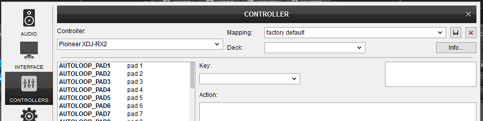

Do you see the mapping you downloaded and installed on the controller setup page?
And if so, is it the currently selected one?
Like the image below?
![](/img/254007/88110/Capture.png)

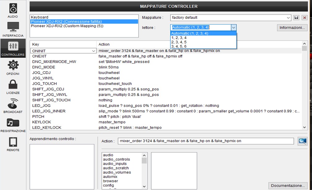

help: problem!
HELLO, I bought the pro package to use my pioneer rx2. I downloaded the map, but it does not work well. only deck 1 works. 2 does not read me anything. why? what settings do they need ??
thank you
this is the download link for rx2: https://www.virtualdj.com/plugins/index.html?addonid=80673
BUONGIORNO, ho acquistato il pacchetto pro per usare la mia rx2 pioneer. ho scaricato la mappa, ma non funziona bene. funziona solo il deck 1. il 2 non mi legge niente. come mai? quali impostazioni servono??
grazie
thank you
grazie
![](/img/257398/55128/rx2.jpg)
Posted Wed 28 Feb 18 @ 11:58 am
