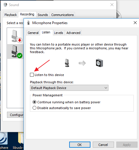

Seems like your Mic Input is picking up some audio signal. Any chance you have this enabled ?
Posted Mon 28 Aug 17 @ 3:46 pm
I have it disabled. Tried disabling everything, but no result: still the beeping. Are there settings in VDJ for the play button beeping, because I find it weird that it beeps when the play button is lit.
