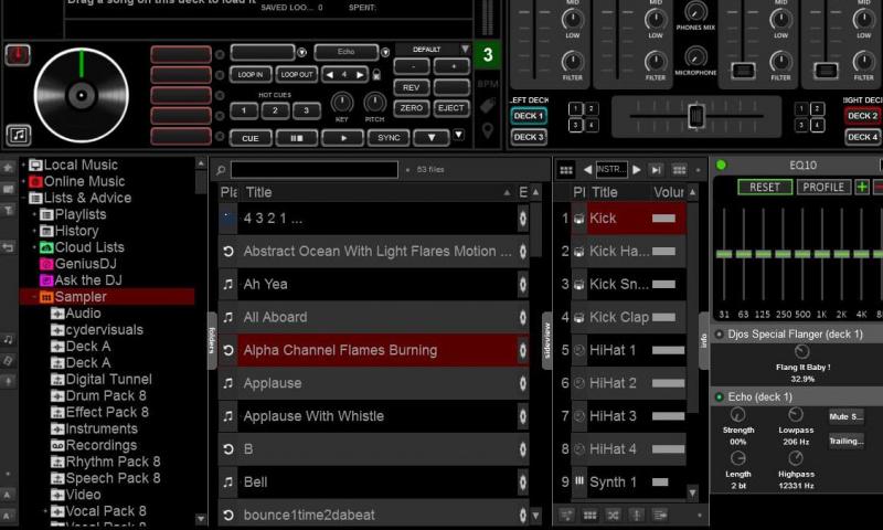

This is how it looks for me. When I play a sample, the sample icon lights up, and the Pos column displays the position in the sample, rotating as the sample plays.

That's the one I posted (you can see the search bar in my screenshot)
Not sure why the icon wouldn't light up for you. Did you try the default skin?
Also you can enable the 'Pos' column for further play info as in my screenshot.

Skin issue. First... I had my POS indicator hidden. Un-hid it. Then I tried a Sample. Nothing. No movement.
Then as you suggested I changed to the DEFAULT Skin. Voila... That works. I see the POS indicator move the full 360 degrees. It would be nice if it was lit up better.
Went back to my "Blacksheep" Skin, and not the same. No movement. So it is a Skin issue.
There must be a command that is missing. I guess I can compare XML files to see if I can find the difference.
