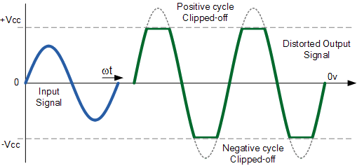

Drivers are very reliable if driven correctly, and not stressing the amp is the key
You can easily kill a 500 watt driver with a 25 watt amp
Speakers like a nice waveform, the normal action of the driver is self cooling , the air being pushed around as the voicecoil moves does this, and you can drive them very hard.
But.
As soon as your amp starts to clip its all over..
What is clipping?, basically it's when the amp can't provide enough drive..
Let's assume your amp has a power supply that can prove a peak output voltage of 60v
Now think of a nice sine wave, it 40 v peak to peak, nice rounded top and bottom tonthe waveform
Now we turn the signal up to a level where it need to be 70 volts peak to peak, well the amp can only provide 60, so as the waveform rises and gets to 60 it can't go any higher it maxed out.
Now the waveform has a flat top, this is now dc , then driver cone is pushed out but is not vibrating , the cooling effect is lost and the voice coil heats up.
Of cause this happens in microseconds, so you hear it as distortion
However if you continue to drive into clipping , the voice coil will get hotter, the wax that holds the very fine voicecoil wire will melt and distort , if the voice coil former now contacts magnets, you left with a driver that will never sound good again, eventually the wire will wear or break and then the driver is open circuit
Sorry about the lecture, I do feel if people understand then basics of how things work, it give them much better understanding of potential problems .
So a much bigger amp than the speaker will mean you will never drive it into clipping, however you can still overdrive the speaker..
For a single driver I would think clipping should not be that much of a problem.
Even the clipped signal will still be alternating at least at the lowest frequency, so for low-frequency drivers that shouldn't be a problem.
The biggest problem with clipping as far as I know is in combination with multiple drivers and a passive cross-over.
In this case the problem is not the total power (say the total power output power of the clipped signal is 200wrms, and the speaker is also rated for 200wrms), but the distribution. The rated speaker handling power would be given a normal distribution of low and high frequencies for music.
Clipping would basically causes harmonics at higher frequencies, so the distribution of power shifts from the woofer to the tweeters, which then get more power than they can handle.

Erm no
Clipping is dc going to the speaker, and it kills voice coils, this is fact , which driver it kills first may dependent of what the program material is, the dc will heat the voice coil but the other signals also contribute

Clipping is both "DC" and harmonics. it's a combination of both.
The "DC" part of the waveform (clipped peaks) generates a lot of heat, but on the other hand, the harmonics associated with the clipping waveform is generally higher up in frequency where the driver impedance has rise and often not cause very high currents.

Clipping is dc on the output , dc has no harmonics, dc is bad for speakers , in a normal setup your amp should never clip, the warming light is there for a reason!
Posted Wed 10 May 17 @ 6:24 am
Of course clipping has harmonics. How do you think a distortion pedal for guitars work? By introducing higher dv/dt you will get harmonics superimposed on the fundamental frequency. An amplifier driven into clipping will be linear all the way between the pos and neg clipping, as it's only the tops which will be clipped.
To achieve DC without harmonics on the output you have to have a failed output stage putting one of the amp rail across the output. And this is taken care of by dc protection on the majority of amps.
