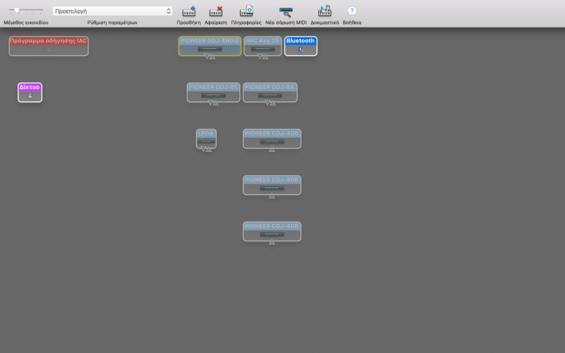

To Bluetooth to exeis apenergopoiimeno ?
Mporeis na dwseis ena screenshot apo MIDI Studio ? (Utlilities->Audio MIDI Setup--> apo menu sto panw meros ->Show Midi Studio)
PS. Pira to arxeio, to koitaw. Me mia prwti matia fainetai na yparxoun para polla re-connections.

Me diplo klik sto Network eikonidio mesa apo to MIDI Studio, to parathyro pou sou anoigei den exei kati energopoiimeno, einai adeio, etsi ?
Den mporw na katalavw ti mporei na pigainei strava. San teleutaia lysi tha itan mia anavathmisi se Siera kai na peraseis ksana tous teleutaious drivers tis konsolas
