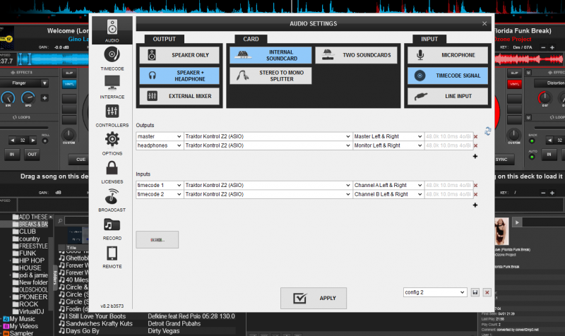

Are there any drivers to use my Traktor Z2 mixer with VDJ? Im using vinyl timecode
Windows OS

the drivers and firmware are hear near the bottom of the page

Thank you Wicked
Im having problems with setting up the audio configuration.

The Traktor Kontrol Z2 should have..
Master .... Traktor Kontrol ASIO ... Chans 1,2 (Master)
Headphones .. Traktor Kontrol ASIO.. Chans 3,4 (Monitor)
As for the Timecode Inputs, they appear to be correctly set.
Take a look at the manual https://virtualdj.com/manuals/hardware/ni/z2.html
BTW, i dont see the "special" Kontrol Z2 button in the Audio Setup (which should offer the pre-defined audio configuration). Was the Z2 connected when u took the screenshot ? If it was, then we need to see why its not offered and we may need to get some data from you.

Thank you for your response. Thats what I had asked tech support, the "special Traktor Z2" tab there with the other sound card lists . I havent gotten an answer yet so please tell me what data you need? I sincerely appreciate your help
Now the Traktor channels are A and B... does it matter whats typed in the setup there? typing chans 1 & 2 verses chans A & B ?
Posted Tue 04 Apr 17 @ 12:31 am
As of now this setup seems to be working. But there still isnt a Traktor sound card in the sound cards page

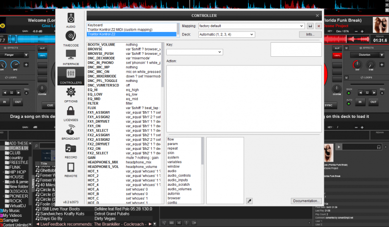

This is the setting that comes up every time I check the controllers tab

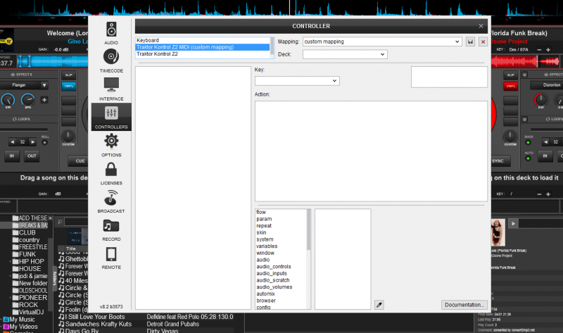

And this is the layout of the other Traktor settings but doesnt seem to make a difference and doesnt stay selected
