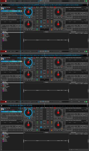

          Think songpos_remain went wrong in this action. Maybe there will be another function (variable) to catch the right time. I modified the standard VDJ skin to let all jogrings blink at "songpos_remain 15000ms ? blink 400ms : songpos_remain 30000ms ? blink : on". It works as long as I play the track normal speed. If I pitch my song "REMAIN (time)" will increase/decrease but the jogring will start blinking <> 30000ms depends on the pitch value more or less.
WIKI: songpos_remain : get the remaining time in %. if used with a parameter (in % or ms), returns true if the time left is less or equal than the value: 'songpos_remain 500ms ? blink'.
Maybe the problem is the value of songpos_remain given in %. Start blinking is always at the same position of the track, but in my case the "30 seconds left" position is not the same when pitched.
