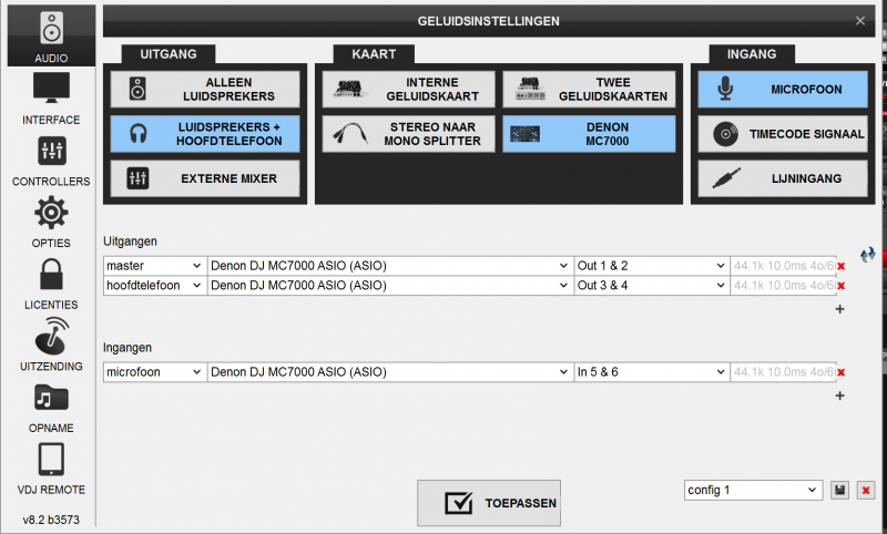

The correct audio config is the one which you're given when pressing the "MC7000" button in the VDJ audio config (or which pops up when you start VDJ).
Master & headphones. Master on MC7000 1&2. Headphones on MC7000 3&4. There is also a recording input.

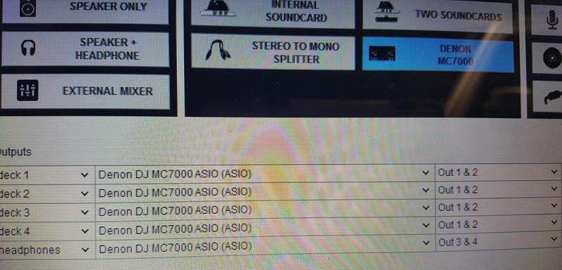

I can't find what I'm after in any of the manuals (VDJ or Denon).
So after playing around with the settings, I get it to work by testing it all at home. See the pic below....
Can anyone tell me if this is a terrible idea? It works.
With these settings, I can listen to one or any combination of the 4 decks in CUE, with any or all of the 4 channels going to the master output, adjustable by the fader on each channel.
It's just like a traditional analogue mixer now.

It should be Master (chans 1,2) & Headphones (chans 3,4).
I dont see why you have to split the channels like that. Doesnt help the SPLIT Headphones issue, which btw i can verify there is one.
If for any reason you need to keep the above, keep in mind that you will not have Effects on Master (in case you need to use one), nor Post-fader effects... there may be other issues too.. cant think of any at the moment.

Oh yea, make sure you have the right volume turned up for the headphones, that knob directly under the "phones" is the split, turn that all the way up and all you will get is master. The knob above the "split" button is the level, max that and turn the split knob all the way to a-clockwise see if that rectifies. Headphone gain was also a bit low for me, you can adjust that in the options, I set mine to 10, a bit deaf. Hope that helped.

I have no problem in the settings. Can this help?

i notice that you are using asio drivers according to someone at vdj they do not support denon & indeed my dnmc 6000 will only work correctly on the wasapi drivers however my pioneer ddj-sz is the other way round
