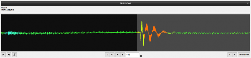

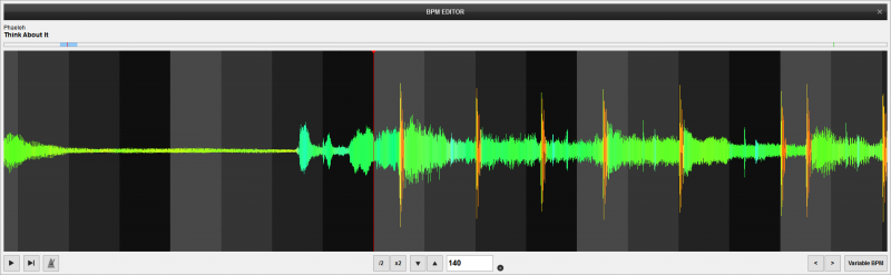

Just in case it is useful:
This image shows a typical attempt at automatic detection of a beat grid. As you can probably imagine, the first beat is actually where you can see the beat. What it's actually selected is a piece of vocal sample.
This second image shows the eighth "beat" in the image which might be what it's trying to detect in this track, except it's not detected that well either.
