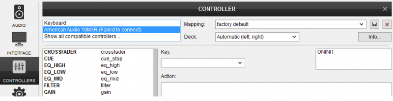

Hi. I am trying to connect my American Audio Mixer to VDJ. I have followed the instructions in the manual and all seems fine - Im able to select the card in the audio tab
However, when I then go to the Controller Tab, I always get a "Failed to Connect"

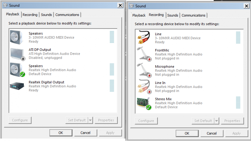

So I've checked my audio properties and it appears Im not using the mixer by default? Its still failing to connect

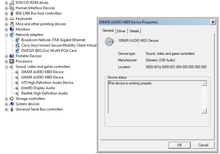

Not sure if this helps, heres my soundcard setup in device manager

If your OS is detecting the MXR (which your pictures prove) then Virtual DJ should be able to see it and connect to it.
On the other hand, your OS is seeing the audio interface part of the MXR. Connection for mapping is the MIDI side of things.
If I were you, I'd use one of those MIDI signal monitoring tools (i.e. MIDI OX) to see if the MXR is sending data when the knobs, buttons etc. are being used.

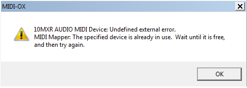

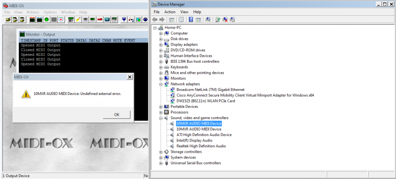

OK. I have tried the USB Oblivion and the MIDI OX system.
Im still no further forward. To be honest, Im not sure what Im doing with the midi OX, but tried what I thought was the way - Options->Midi Devices-Selecting my mixer and pressing O.K, but then get the error message below.
If I also choose the midi mapper and press O.K I get the its already in use (Virtual DJ is closed)
Posted Mon 02 Jan 17 @ 9:32 pm
Some other application is using the 10MXR MIDI and VirtualDJ (or MIDIOX) cannot use that.
So check Windows Task Manager and see if another application may be running (even another VDJ instance) at the same time.
There could also be a faulty driver of another device on your computer (such as Logiteck products, Web Camera , bluetooth device/driver etc) that could conflict (use the same driver), so try to disconnect any other USB devices and/or disable camera, bluetooth etc and then try to open VirtualDJ again.
Posted Tue 03 Jan 17 @ 2:16 pm

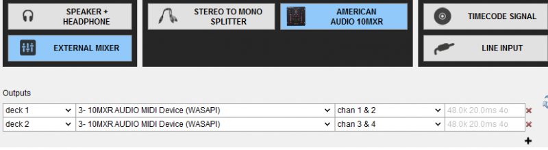

Hi. Although I'm very grateful for everyone's help, I am close to just abandonning VDJ as nothing I do seems to be working with my 10MXR mixer and just go back to just using my mixer with turntables. Its a shame as VDJ is pretty fantastic!
However last night I did have a small amount of success.
In VDJ I changed th audio config setting from ADJ ASIO (as per manual) to 10 MXR Audio device and I now get sound from VDJ through my mixer and I can use the cross fade on my mixer to swap between the decks in VDJ.
But, Im not able to see the crossfader move in VDJ and none of my other midi functions on my mixer are working. I also get unde rthe controller setting that its failed to connect. Any suggestions before I give up?
How can the cross fade on my mixer control the one on VDJ yet its failed to connect?

You need to bear in mind that you're using an external mixer setup.
In this config, the internal (on screen) mixer is not being used. As per your audio config, audio from each deck is being sent directly to your hardware mixer, not through the VDJ "virtual" one. In other words, you don't need the mixer on screen any more. You have a real one. You can use a skin that has no mixer graphics.
It doesn't matter that the mixer controls don't send MIDI to VDJ in this config, because you don't need to use the VDJ mixer.
If your MIDI was working, you might see the controls moving on the VDJ screen, but those are fake actions. The software mixer is doing nothing.
