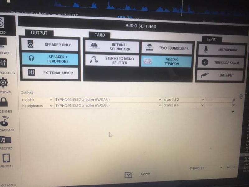

Please post a screen grab of your VDJ audio config setup.

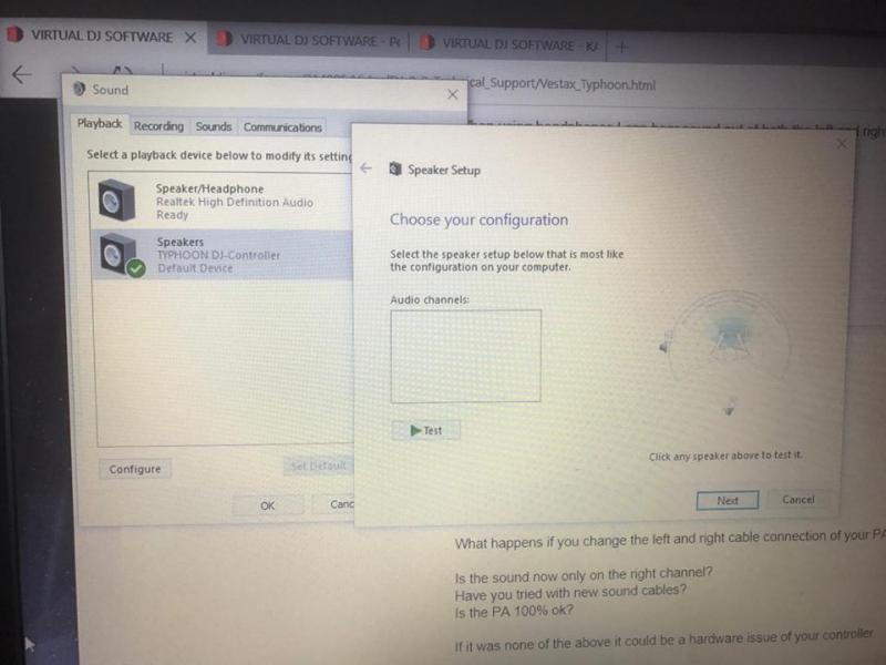

I've just noticed that when I check the playback setting that the vestax is only showing as read and centre.

Have noticed that windows show my vestax as this?

- make sure the ASIO drivers are used in the Audio setup as shown in the pic above.
- try to set your computer's built-in sound card as default for Windows instead of the Typhoon card
