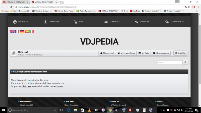

THIS IS WHAT YOUR LINK TAKES ME TO

Thank you for your response but I'm still unable to create a knob on the skin. what I want to do is add a key smooth knob on the skin. I'll be using the mouse to turn it. I don't have a physical controller to link it to. Just like in virtual dj 8.0, there was a customizable knob on each of the four decks. Is that not available in this new build ?

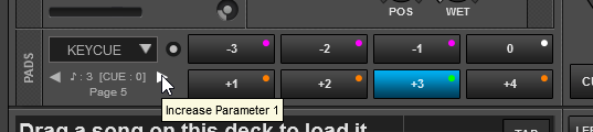

You can also use the KeyCue Pad page which offers Key -/+ navigation via the Parameter buttons (arrows)
