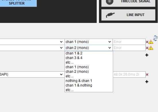

Is there a way in VDJ to turn the sound output to mono? I can't find that option.
I ask because some older "stereo" recordings have the voices on one side and the instruments on the other, which can be undesirable with certain equipment setups...

There are mono options in the sound config.

I don't think there's a way of doing this just with a button.
You can try this plugin though which allows you to play about with the channels (left/right only) or reverse them. That may be a solution.
http://www.virtualdj.com/plugins/index.html?category=effects&search=stereo

that plugin when set to stereo mix, combines left and right signals to 2 mono signals.

Just about to post that myself!

Well there you have it: I'm served!
Thank you both (and Scott of course, for making it)!!!
