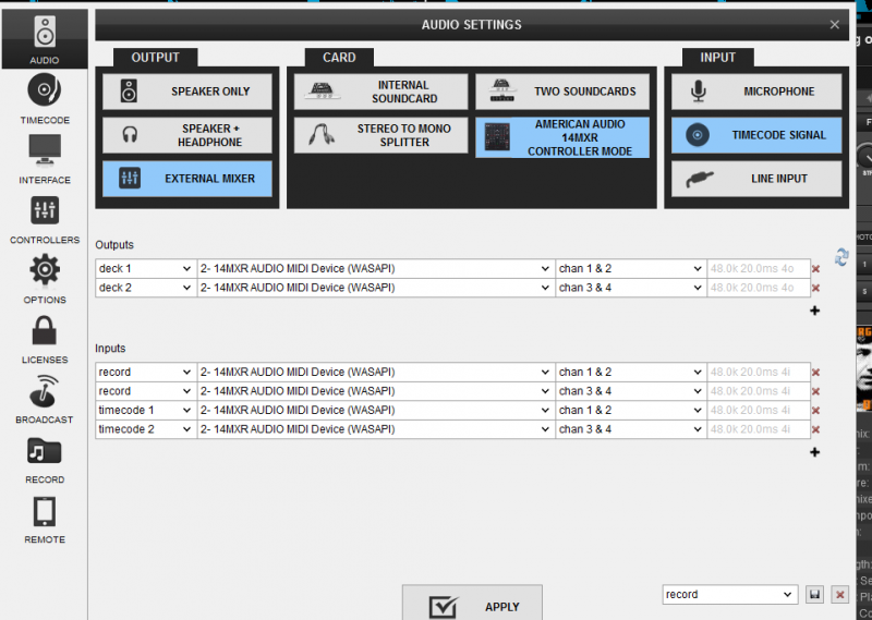

I can record and the green LED recording bar moves with the music as I am recording but when I listen to the playback its nothing but timecode noise or something. Help

Timecode noise or something? Are you using timecode? Please give details of your equipment / setup.

Yes. Vinyl timecode. I dont know how to describe the noise other than loud fluctuating beeping noises instead of music.

@djreels
We need to know what controller/mixer/soundcard you are using, how these are connected and a screenshot of the Audio setup of VirtualDJ.

apologies. Im using an American Audio 14MXR with tunrtables

Since you are using the Audio Interface Inputs of the Mixer for Timecodes, you cannot record the way the manual describes https://virtualdj.com/manuals/hardware/americanaudio/14mxr/record.html
So, you have to follow this way...
- Connect the Booth Output of the 14MXR to the Line Input of your computer (or another USB sound card) using a proper RCA to 1/8" (or RCA to RCA) cable
- Add the following record line to the TIMECODE Audio setup as per the manual (deck1/deck2/timecode1/timecode2) ...
record YourComputerBuiltInSoundcard Chans 1,2

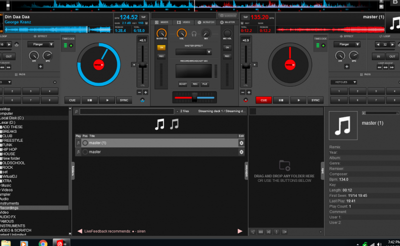

Well I can record and the music plays back that Im recording. So that part is successful. However, its like the crossfader and volume sliders on the mixer dont exist because the tracks from both turntables are playing/recorded (recorded file) outloud regardless of either of them being in cue. (sighs)

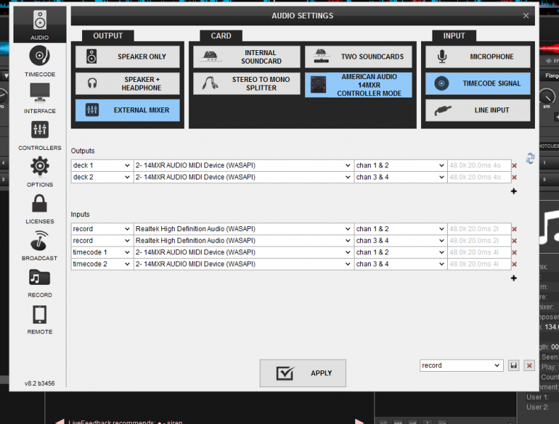

djreels wrote :
There are 2 settings for the recording input
Posted Sat 19 Nov 16 @ 12:31 am

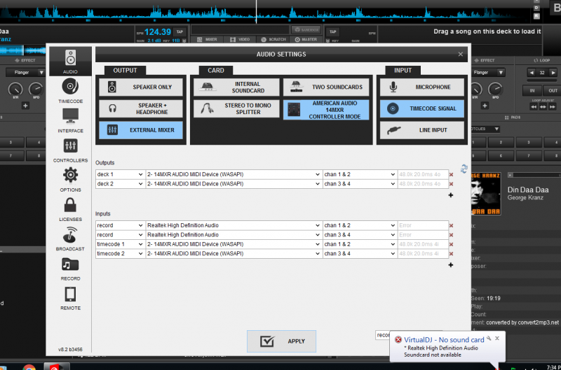

And now as Im trying different configurations to record with... I get a soundcard error as you can see( on the bottom) even though the mixer's soundcard IS working ( notice the music waveform up top) as the programs operating.
Posted Sat 19 Nov 16 @ 12:37 am

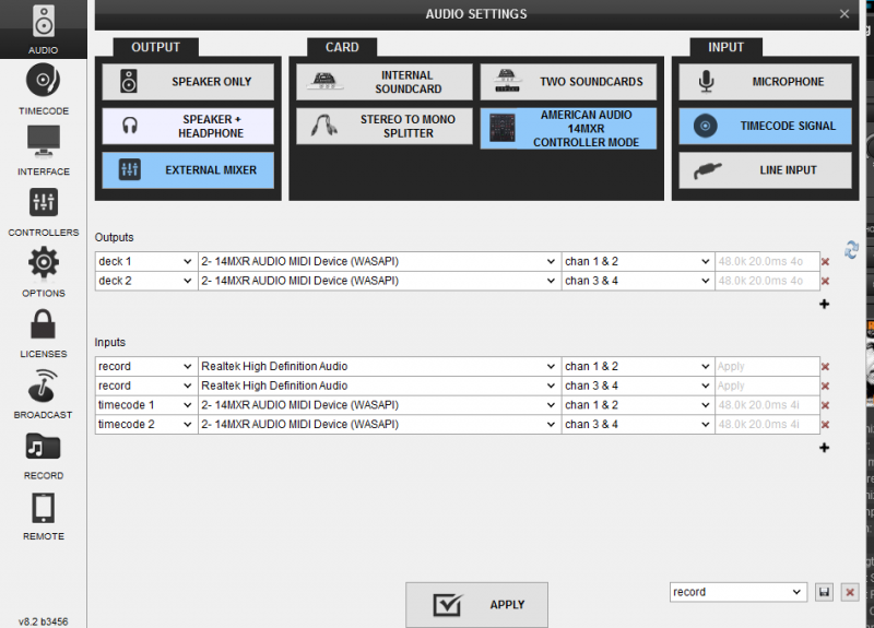

now recording using this setting the playback is only playing at a fraction of the speed... reaaal slow like playing a 45 record on 33
