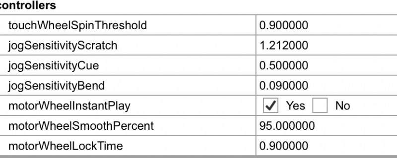

I was testing out the New update for the weekN & now my jog wheel has a delay/pause when releasing/scratching & I didn't change the the jog wheel setting

So, the delay is when the jog is released ?
Tr y to set the setting touchWheelSpinThreshold to a lower value , like 0.5 or even lower.
Also check what you have for the rampScratchTime setting. Start with the default value 0.1 and try to go lower.

but it been ok after setting from 8.0 so I need to redo my jog after new updates ?
Posted Sat 12 Nov 16 @ 3:47 pm
IIRC touchWheelSpinThreshold was not present in 8.0
touchWheelSpinThreshold default value is 0.8 while in your picture above, it shows 0.9, so most likely it was manually set that way and not by some update
btw, did you try with a lower value ? Did the delay got improved ?
