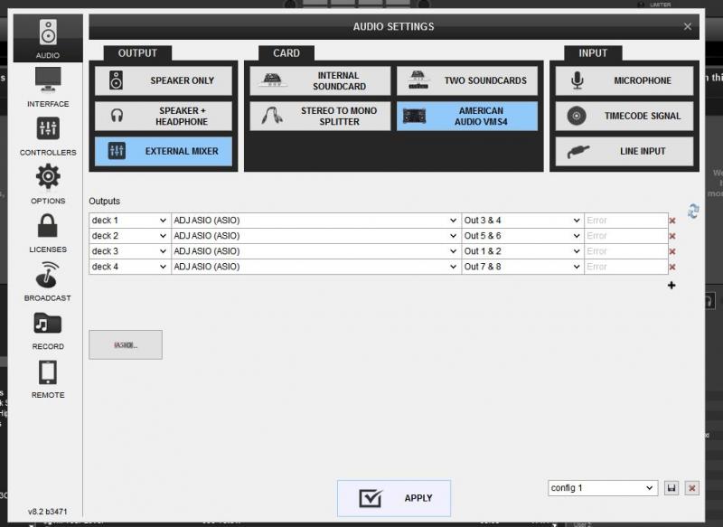

This is what I get when I connect my controller;

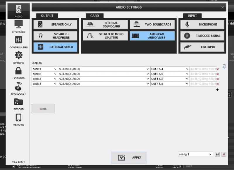

This is what happens after about 8 seconds;

[18:02] Midi out device reconnected: Microsoft GS Wavetable Synth
Midi out device detected, name:Microsoft GS Wavetable Synth mid:1 pid:27
--- 2016/11/02 - 21:53 (3471)
Audio device found: name="VMS4 AUDIO MIDI Device" vid="0x04D8" pid="0x0A0A" hardwareID:"{0.0.0.00000000}.{77351b56-ce78-4c13-8e03-3dfd6b50a4e1}"
Audio device found: input name="VMS4 AUDIO MIDI Device" vid="0x04D8" pid="0x0A0A" hardwareID:"{0.0.1.00000000}.{10b88271-7c24-45fc-b59a-40172d9a60f1}"
[21:53] Midi out device reconnected: Microsoft GS Wavetable Synth
MIDI Device Identifying: \\?\usb#vid_04d8&pid_0a0a&mi_03#7&24500bdd&0&0003#{6994ad04-93ef-11d0-a3cc-00a0c9223196}\global (in:0 out:1)
MIDI Device Identified by PID/VID: \\?\usb#vid_04d8&pid_0a0a&mi_03#7&24500bdd&0&0003#{6994ad04-93ef-11d0-a3cc-00a0c9223196}\global : American Audio VMS4
Posted Wed 02 Nov 16 @ 9:59 pm
Is the VMS4 in 8out mode ?
BTW, the changelog doesnt seem to detect the ADJ ASIO drivers, so definitely those were not properly installed or you have installed incorrect drivers.
Is is VMS4 or VMS4.1 ?
Where did you get the drivers from (link) ?
There must be a way to open the ADJ ASIO Utility panel without opening VirtualDJ. If you find it, try to open it and post a screenshot here.
I also noticed sever "re connections" even for the Microsoft GS Wavetable Synth !! So there must be something wrong in the USB drivers that Windows are using in your computer.
Posted Thu 03 Nov 16 @ 1:08 am
The VMS4 is in 8-Out mode
It is the VMS4
The drivers were downloaded from here: http://vms4.adjfocus.com/downloads/downloads/vms-41.html
I have not found a way to open the Utility panel
In device manager all items check out ok with no conflicts.
It is the VMS4
Posted Thu 03 Nov 16 @ 7:46 pm
I would say you need to start by using the VMS4 driver, not the VMS4.1 driver.
Posted Thu 03 Nov 16 @ 7:55 pm
