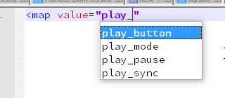

You mean an auto-completion of the VDJ script verbs when you create a mapping file ?
Like this ?
In this case you need to add all the vdj script verbs in the XML API file located in ProgrmFiles/NotePad++/Plugins/APIs/ folder (xml.xml file)
Like this ?
Posted Thu 13 Oct 16 @ 1:55 am
