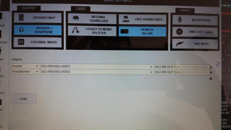

I took both of your advice. Somewhat fixed the problem. Now instead of hearing exactly what is coming out of the speakers, I now hear both songs together in the headphones. Here is the new setting. What am I doing wrong?
Posted Tue 11 Oct 16 @ 7:40 pm
in the middle of you controller above the channel level indicator there are two small buttons labeled cue. if they are both on you hear both sides in the headphones. if one is on you hear one :-)
Posted Tue 11 Oct 16 @ 10:26 pm
