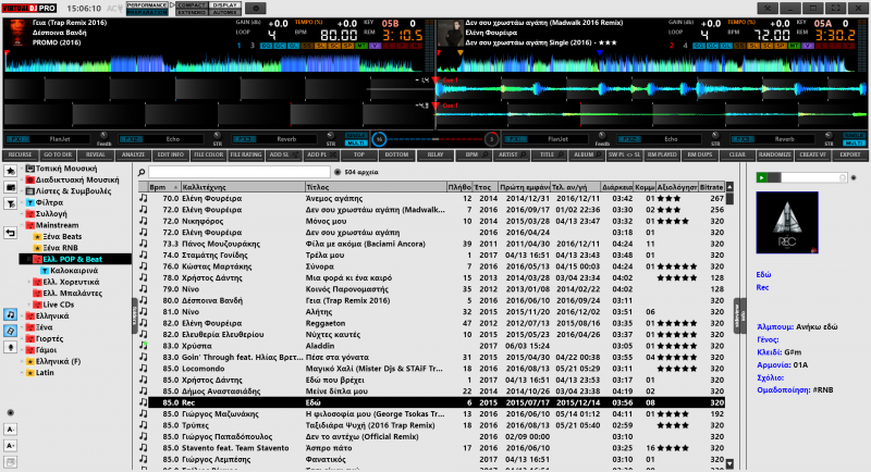

Yes, the options are the same for browser columns and info panel.
However you don't have to use the same options on both.
Look at my browser above
Main browser window has BPM, Artist, Title, Playcount, Year, First Seen, Last Play, Length, Track, Rating and Bitrate visible.
Info panel has Album, Genre, Key, Harmonic, Comment and Grouping.
As you can see the info is NOT the same on both main browser and info panel (with the exception of Artist & Title that you can't switch off)
Anyway, this thread is about a particular skin, not about the info panel itself. The info panel cannot be customized by a skin. You can only set it's colors (background, stripes, captions etc) as on the rest browser.

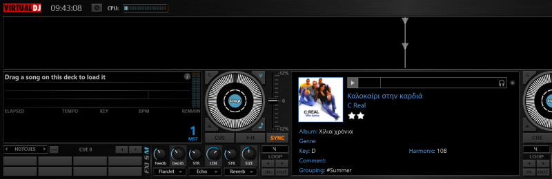

You mean something like this?
That's already present on SilverSleek 3 if you want to take a look.
Or something else ?

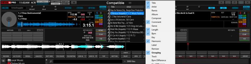

More like this
center panel in thr extended view
a compatible list, the option window was an idea of choices for match criteria.
not all of them but those people use for tagging music. Like my critiria would be grouping
Or file path. the bpm and key criteria has to be applied also.
Posted Sat 27 May 17 @ 1:21 am
So actually you want to display a FILTER folder there ?
Posted Sat 27 May 17 @ 6:02 am
well if the filter folder can be made to change its contents according to the track on focused deck.
