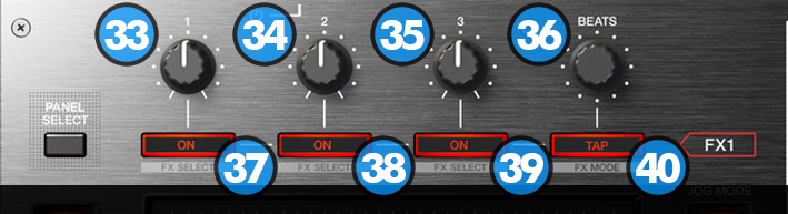

The FX1 & FX2 buttons on the mixer section of SX have changed completely. Now they clone the effects from one deck to another.
Therefore you don't use these buttons anymore to tell which FX unit will control the effects of the deck.
With the 8.2 mapping:
1) FX1 & FX2 buttons clone the effects from one deck to another
2) FX Unit 1 (left side) controls the effects of the current left deck
3) FX Unit 2 (right side) controls the effects of the current right deck
For Single FX mode:
4) First knob of the FX Unit (FXU) controls the strength of the effect
5) First button of the FXU activates/deactivates the effect
6) Second knob of the FXU controls additional parameters
7) Second button selects the previous effect on the effect list
8) Third knob of the FXU controls additional parameters
9) Third button selects next effect on the effects list.
So basically, button 37 turns on/off the effect, and buttons 38 and 39 scroll through the effects (allow you to select the effect you wish to apply) and knob 33 controls the strength of the effect.
I can't see how this is complicated. There's no need to use SHIFT button to simply control the effect in Single FX mode

Just a heads up. The big difference between the previous mapping version and the current one, is that the FX1 and FX2 units are now dedicated to the left and right decks respectively. In the previous mapping files you could assign the 2 FX units to whatever decks you wish via the FX1/FX2 buttons, but as explained above, those buttons now simply clone the effects from one deck to the other.

I honestly don't know if it is something wrong with my controller or the mapping. Mind you i am having these issues in factory default mapping. This is in detail what is going on (a copy of which i sent to support)
In Single FX mode
The only effect in my bank that the buttons work according to the manual is Reverb. I can select it using the second button and turn it on and off using the first button. I can use the first knob to manage the strength. With any other effect in my bank, i can select it using button 2 but i can not turn it on using the first button. Even if i manually turn an effect (that is apart from Reverb) in VDJ using the mouse, the first button cannot turn it off but i can use the first knob to control strength and must use the computer to turn it off.
In Multi FX Mode:
All the KNOBS work as in the manual.
Button one turns on and off effect 2. Button 2 turns on and off effect 2. Button 3 turns on and off effect 3. I cannot turn on or off effect one with any of the buttons.
Any ideas? Thanks for your help.

FX 2_1_On, is mapped wrong, reads 'effect_active 2'
should read 'effect_active 1'
Same error on SX2 mapping too.
Posted Sat 17 Sep 16 @ 4:23 am
Thanks a billion. Effects issues resolved.
