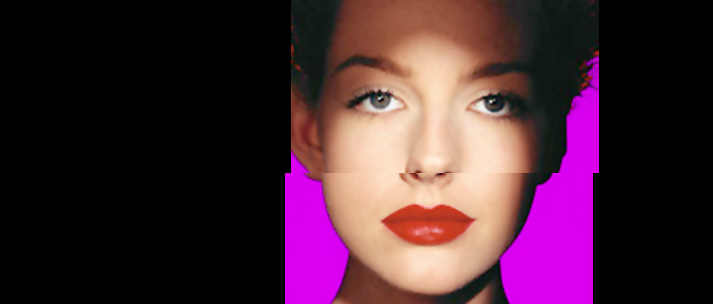

What is tearing?
Posted Thu 08 Sep 16 @ 4:55 am
Since your monitor is refreshing itself normally about 60 times per second, it can cause artifacts if you draw when the monitor is refreshing. So you draw an image say and part of it got drawn in one refresh cycle and the other part gets drawn in a different cycle. It can look pretty messy. So you try and wait when the monitor is not refreshing itself to draw your image. It does not always work well but I think it is getting better with newer hardware. Normally it is not as clean as the following image and normally sort of blurred and ragged where the tearing is occurring. It can be sharp though. In this image you can see the bottom part is shifted to the left. If the image is not moving then you won't see tearing at all. Videos tend to wash it out as well.
Download and run this in TellyVisuals. It just scrolls a full height image from right to left. Make it full screen since the tearing can appear anywhere from the top of the monitor to the bottom. You will notice it quickly if tearing is occurring... If it stutters then that is a different thing. When everything is good it should be slick smooth with no tearing or stutter. Stutter is when it jumps a bit due to missed timing. I run it at 60 FPS in VDJ to match my vertical sync rate.
