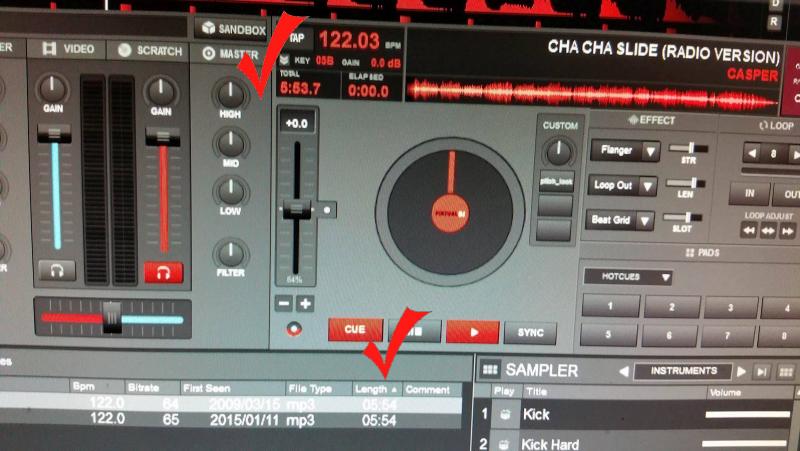

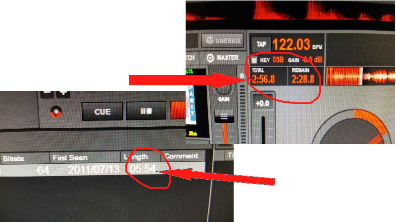

this ONLY happens with ONE song and one song only...
the song still plays just fine so far but the times in there are just really off.

Its the file. I have seen that happen for years, even back in the winamp days. Yes the track time make have been correct at one time but something is corrupted in the file that deliverers that information to the player. Its weird

I have seen files say they are 4 hours long and even match on the track position but in reality it was only like 4 mins and plays fine lol weird

The same song shows the correct time in the current stable version?
Posted Sat 03 Sep 16 @ 7:31 am
just installed public build 3343 and it does show correct length and time remaining
this didn't do it in any previous early access. and where I work is VERY time specific so kinda threw me off and is why I noticed it

Bitrate 64 seems rather low (or wrong).
How's the file encoded? CBR or VBR?

The file is probably 22khz, will be fixed in next build. (Although it is probably a good idea to replace the file with a better quality one if you plan to use it in public :) )

the file is 22050hz (I had to look) and is an edit I did years ago that has played with no issue. and with 8.2 sounds even better than before but even other files as old sound much much better with 8.2 (kudos to the devs!)
so for an experiment I installed b3390 again and lo and behold... below a certain hz... the time/length is off. interesting.

You really should get yourself a copy that's 44100. At 22K sample rate there won't be any high frequencies over 10K.
Now OK, maybe the track doesn't have a lot of highs in it anyway, and maybe you can't hear that high anyway (depending on your age etc) but 44100 is a well established standard and shouldn't cause any playback issues in software or hardware - and will sound better to boot.
