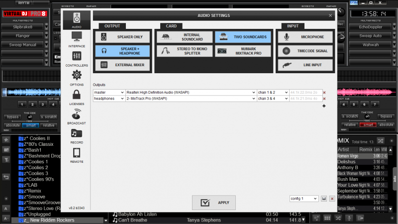

probably best if you can supply a screen cap of your audio setup
Posted Sun 28 Aug 16 @ 12:45 pm
Posted Sun 28 Aug 16 @ 1:02 pm
It looks like you are sending master to the laptop sound card and the headphones to the controller sound card
Your setups should look something like the one in the link below (that is from a QUAD but apart from that it should be the same)

locodog wrote :
try dropping the volume of the cued track, do you still hear it on master? you may have disabled the crossfader.
I have tried volume change of both cue volume and deck volume of cued track and still the sound comes out with master.
I have checked my crossfader and it is not disabled.

Please check the headphones mix knob. I don't know if the skin you're using has one, but on default skin it's located on "MASTER" panel on the center of the screen. Set it all the way to the left.
Just tried that and got no change.

@PachN, no, not in his case:
He's using the Mixtrack soundcard for the headphones. The mixtrack offers 4 channels. Ch 1&2 are the master output, Ch 3&4 are the headphones.
So, in his case (that he wants to hear the sound from the laptop speakers - does not connect speakers on controller's master output) his sound setup is correct.
Master sound goes to on board soundcard (ch 1&2) and headphones go to Mixtrack soundcard, (ch 3&4) since that's where the headphones are connected. :)
As mentioned before, this was my original set-up that no longer works. I have tried it an infinite number of times and get no change in the lack of sound separation.

So, to get this straight:
When using the sound setup of the photo above (with the controller connected of course) you get the sound of headphones MIXED with the sound of master on your laptops speakers ? Because I understand that you get the sound mixed on your headphones...
Using the phot of the sound set-up above, as well as any other sound set-up possible, I get both coming through main speakers and am unable to stop my cue sound from being heard out loud instead of on my headphones only.
I have uninstalled and reinstalled VDJ 8.2 and still have not been able to fix this.
It works fine using VDJ 7 but I can now only get the free home version, which doesn't work with my controller beyond the allocated 10 minute trial.
