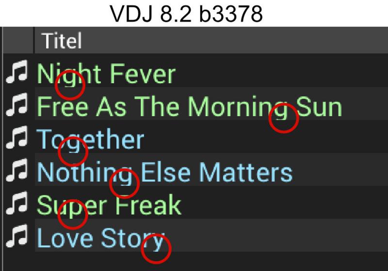

VDJ 8.2 does cut off some letters of fonts other than the default. In my Skin I have used the font Roboto from Google. As you see in the screenshots, especially the letters "g", "y" and "p" are cut off at the bottom, as the line height is not sufficient. I have marked those letters with a red circle.

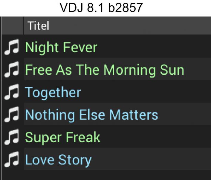

In 8.1 everything looked great, as you can see in the second screenshot.
The way it looks like now is cramped and it is acutally harder to read the list of songs. So I strongly hope this issue will be addressed, as I wont move to 8.2. before that is solved.

    I wrote about this issue earlier, but to make it more clear (and since the old subject was confusing) I am opening a new topic.
