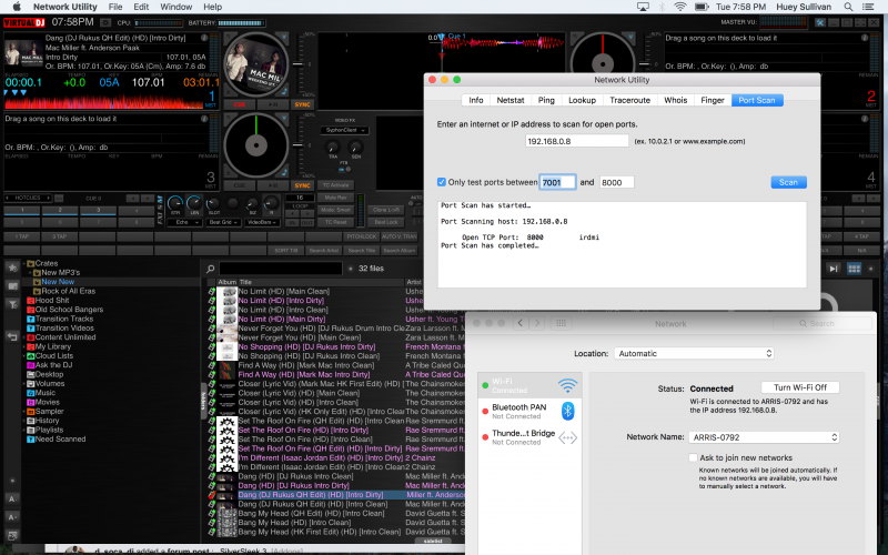

Ok what should be my "Inbound port" and my "Local Port"??
Is this where I type in the 8000??
OK I think I managed to open port 8000, heres a screen shot
But this site still gives me an error??

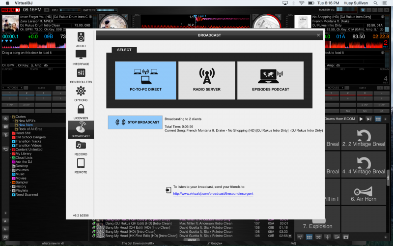

Ok I got the PC 2 PC broadcasting to work,
And I can hear it on my iPhones but this site still says ERROR and that I need to open port 8000 but it clearly is.
So next Ill try to upload another podcast.
And after rereading this thread again I see Scott did say I would get an error but yes it'll work.

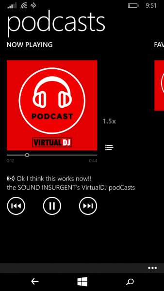

And I had the PodCast coming threw my windows phone now,
AWESOME!!
