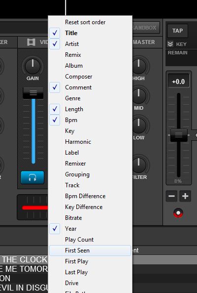

Hi all, Just recently done a V8.2 upgrade. And discovered that all my created Playlists have lost their natural order of play. As I change my main list to BPM order and then went into my playlists, these also have been re-arranged into BPM order. And if I then do by Artist the playlists also appear in that order. This did not use to happen and is now a major issue for myself as I use to note playlist order for years and then started to rely on VDJ as it use to hold the order in place regardless. Can this be put back?

Load your playlist in the browser, right click on one of the browser columns, select "reset sort order" at the top and see what happens .....

Thanks, I had wondered if that would do it, and it did.
However since posting, I had an epiphany.... went into Settings and Options (browser section) keepSortOrder - switched from Yes to No and voila! keeps all my playlists in their original view rather than changing to match my main view.
