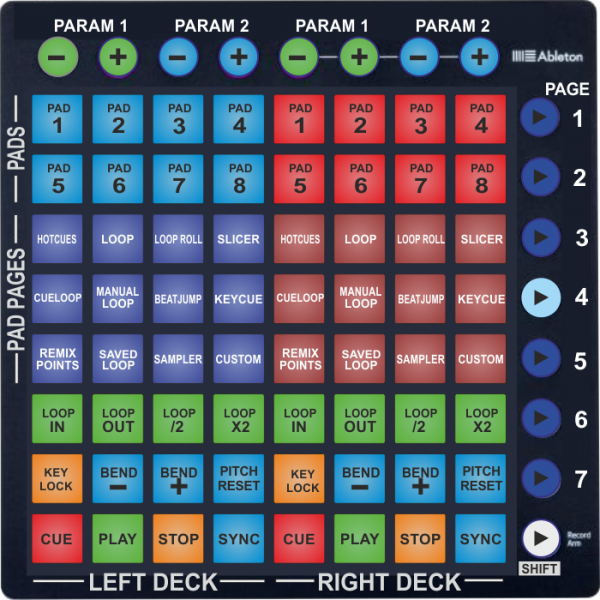

@raypitman. What exactly do you expect as update in version 8.2 for this unit ? You dont expect to see all 64 pads on the skin/screen, right ?

Why not, 8pads 4params 2padpages * 4 decks and you've used 56
even 16 shifted/pads * 2 decks you've used 44.

Its not a matter of saving buttons, using pads is mostly used to see on the skin what is assigned, and since the default skin (and the Pads Editor itself) only shows 8 Pads per deck, you will not be able to assign all the unit's pads as "pads" so you will end up with 16 pads showing on the skin and the rest 48 to not knowing what they are assigned as.

@ DjDad, no I don't expect to see all 64 buttons on my screen, that sort of defeats the object of having a controller, I'm just trying to avoid using the mouse/keyboard so much and would prefer to have the pads page shown on my launchpad. Since the pads page(s) is very new, that's what I mean when I say it hasn't been updated. Sorry for the confusion.

Ok, in next update (will post here when available), a 4th Page is added to the default mapping to offer control of the Pads section of VirtualDJ default skins

oh yes, that's more or less exactly what I meant, I'm looking forward to try it out. Thank you.

looks nice. Is it also available for the launchpad S?

@djdad... Nice! Thanks. I know you put some time into this.
