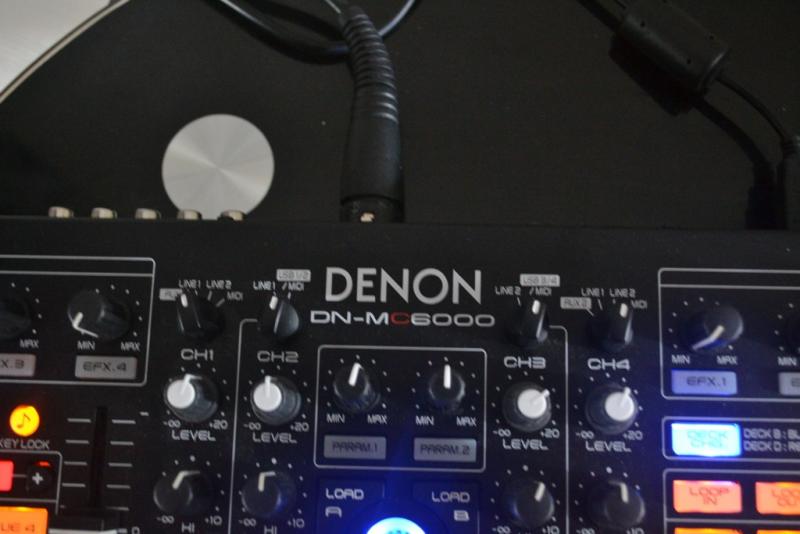

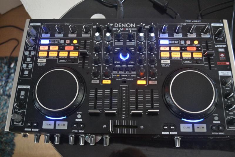

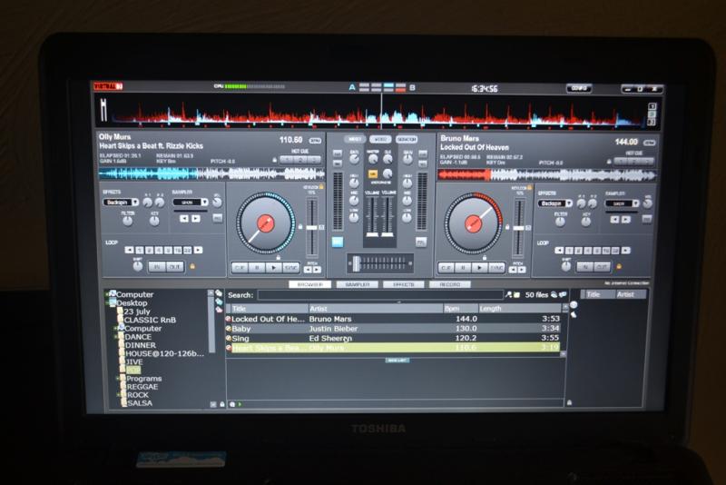

Hi all i hope someone out there can help. I have a Denon mc6000 with VDJ7.4 running with 2 decks. I want to use sliders 2 and 3 to run my decks A and B.
I have placed my MIDI switch at the top of the controller to midi for both 2 and 3 but to my amusement the music is coming out back to front in which i mean when i start Deck A and slide up ch 2 nothing comes out but comes out in ch 3 and vice versa.
Any ideas how to correct this. I'll attach some pics.

Is the External mixer mode that you are using with the MC6000 ? If so, then maybe you need to invert the channels in the Audio Setup.

He can't be using that mode, as he's got the channel switches in the MIDI position. They need to be in the USB position for external mixer mode.

In that case you need a mapping with a different mixer order
Try this one..
http://www.virtualdj.com/addons/15696/MC-6000_Full_3-1-2-4.html
PS. With version 8, it would not be a problem at all btw.

Thanks Djdad i think i may need to move up to VDJ8 eventually.

Thanks Groove i'll give that a go. Currently on ch1 - 4 but hoping to give these a break and get onto ch 2-3
many thanks
