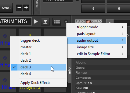

There are several ways to do that.. Here is 2 of them..
- Assign a Custom knob or a knob on your controller as .. sampler_volume_master
How to map a controller key (button/knob) : http://www.virtualdj.com/manuals/virtualdj8/settings/controllers.html
How to assign a Custom button/knob : http://www.virtualdj.com/manuals/virtualdj8/interface/decks/decksadvanced/custombuttons/index.html
- You can assign Sampler to a spare deck. E.g. if you use 2 decks to mix, you can use the 4 Decks skin and assign Sampler to deck 3 or deck 4. Then you can use the Volume Fader of that deck to control the Sampler Volume.
Selection is done from the Sampler Options ->Audio Output
This way will also give you an extra option (from the same menu) to apply EQ, effects and Filter to the Sampler

You dont have to delete any mapping file. Simply goto the CONTROLLERS tab of settings and make sure the "factory default" mapping is selected on the right side for the DDJ-SX2.
If it works with the default mapping, then something is incorrectly assigned to your custom one.
Posted Tue 19 Jul 16 @ 4:11 pm
BTW, since you are on a DDJ-SX2 with a dedicated Sampler Volume knob, you dont have to assign the Sampler to any deck as previously showed you. So go back to the Sampler Options menu and make sure the Sampler is not assigned to any deck, but on Master..
Posted Tue 19 Jul 16 @ 4:13 pm
