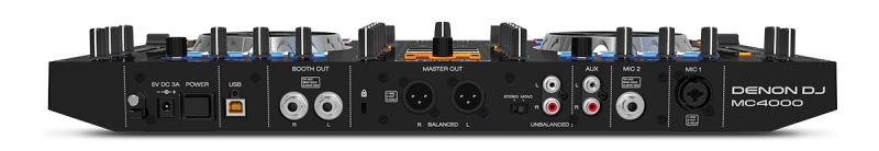

I'm loving my Denon mc4000, so flawless with virtual dj 8, no glitches, brilliant! :D
Now I need a power adapter as i like to carry a spare. Does anyone know or can post a link where i can get one ? thanks :)
Posted Sat 01 Oct 16 @ 8:02 am
Never looked into it but I suppose you could just call Denon up themselves and order one straight from them....
Posted Sun 02 Oct 16 @ 12:10 pm
From what I remember it's a 6v 3a centre positive DC supply.
Posted Sun 02 Oct 16 @ 12:50 pm
back of the unit says 5volt 3 amp center positive
Posted Sun 02 Oct 16 @ 1:32 pm
Thanks guys, I'll order it from denon to be on the safe side :)
Posted Wed 05 Oct 16 @ 2:17 pm
