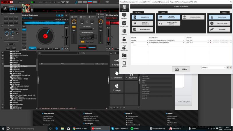

Even further now, I can get music through to broadcast, but when I use the mic there is still feedback, and can hear myself - which isn't ideal.
Going to add a screenshot of the settings to get a clearer idea so someone might know what i'm doing wrong.

If you're getting feedback (a loud squealing sound) then your speakers are too close to your mic, and the mic is picking up the sound, amplifying it again and sending it back to the speakers. Solution = move your speakers further away, turn them down or use headphones.
Surely you want to be able to hear yourself when you speak? Otherwise, how do you judge levels?
It's normal practice for broadcast DJs to a) wear headphones and b) be able to hear themselves in the headphones.

I know what you mean, it is standard practice.
I'm having the same issues, regardless if i've got headphones on or not, it's not a massive hissing, just this annoying humming sound in the background.
I've used really rubbish software in the past (Winamp et al) and not had this problem, regarding distance away from the speakers (feedback) or else. So i'm not sure what's causing it here.

If you go to the sound options of your computer, is the mic turned on?
Look under the recording tab and make sure that your levels are up and it's not on mute. On the main tab, when you talk, you should see a level meter moving. If not, something is muted or turned way down.

A background humming sound is not feedback.
You might have a ground loop.
