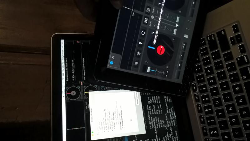

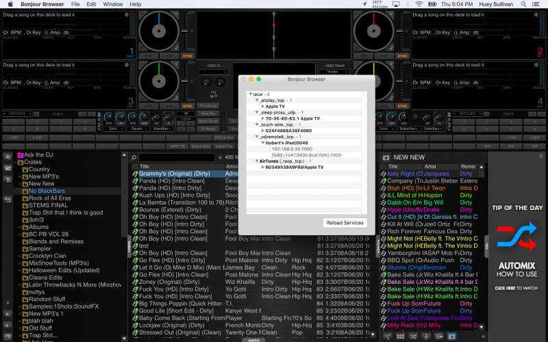

Well I don't think you were referring to me Scott but I downloaded that app and heres some screen shots showing that my Macbook sees my iPad but VDJ won't connect.
Here you can my MacBook sees my iPad but VDJ wont connect.
When I try to type in the ip address VDJ freezes and I get the pinwheel unto I force close.
Posted Thu 23 Jun 16 @ 10:10 pm
I wasn't, no, that advice was for Mark.
I'm unsure what to recommend for you I'm afraid; I've never seen that happen before. Connects on my OS X machine perfectly every time. I'll do some digging around and see if I can find anything.
