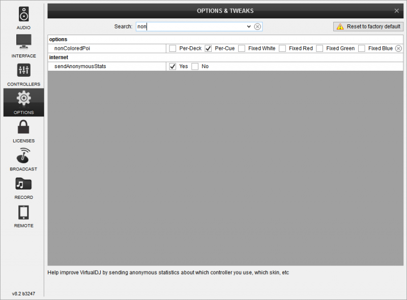

Please check the "nonColoredPOI" setting

nonColoredPOI setting
set to per cue

hi locodog, i´ll reply later more detailed, stuff looks wrong on many levels. first of i got to instances of the jogvision controller, each LED-hotcue 4 mapped to -> hotcue 4 ? cue_color 4 : off <- but still, left deck and right deck show different led colors for cue 4. Screenshots and a pic of those cuebottons might help i guess, i´ll add those later.
just to clarify, noncolouredPOI is set to "per cue", starting there, how can i set the repective colors for cuebutton 1,2,3,4? Should one use the pads-editor (didnt work if i remember right), or use the POI-Editor (wich wont load for me unless i load a track to the deck. Than changes done in the POI-editor to the color of cue4 only change the color for this perticular track.

On the nonColoredPOI setting
Try the fixed red option to prove it is blown
