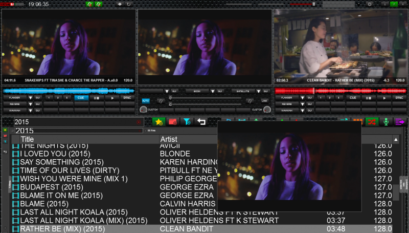

Hey guys, just updated to latest version b3236 and my video output window is now distorted, worked fine before update, tried numerous files to see if it was related to a file type, changed dvxa settings etc but still the same, uplaoded image of screens and settings used. Is this happening to anyone else, if so, whats the fix. Cheers.

It's only the master preview, or also the actual video output?
No transition or effect active? Also happening with default skin?

I haven't been able to test output to screen as this is on the desktop, originally it happened on all three windows but I rebooted system and re started now only master preview is affected also on default skin (sorry, I should have said earlier I had tried that).
I've also tried running default v7 with no problems.

Ok, found the problem, it's related to the resizable output window, when it is minimised/resized all the way down to it's smallest size it causes the problem in the centre monitor window, when enlarged it clears up the problem with distortion.
Only found the window because it was hiding the clock on the skin when I went to check the time, maybe's a minimum window to resize too might be put in place so users either have to switch window off or minimise completely, just a thought.

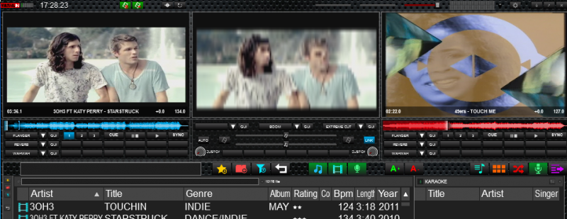

Here is the decks now...
Thanks for prompt response.

The video output is rendered at the resolution of the output window, so if it's only a few pixels, the preview will also show only these few pixels stretched to the preview size.
There is a minimum size for the video window, but I suppose it is still quite small.
