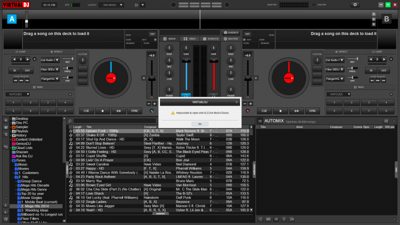

Well, it appears that exporting the default skin breaks the ability to switch between 2 and 4 decks. As well as some other issues.
Many methods being discussed here. Seems to me like it would be pretty simple to make a setting for the clock preference Options panel. I still stand with the OP on this.
How so?
I exported the default skin last time when the changes in v8.2 came, did my little changes that I normally do, gave it a new name, and selected it in VDJ
I can switch between decks without problems
Posted Sun 25 Sep 16 @ 1:52 pm

klausmogensen wrote :
How so?
How so?
@klausmogensen - Here is my error. Stop arguing with me now please. You know what the thread is about. If you do not support it then go someplace else.
